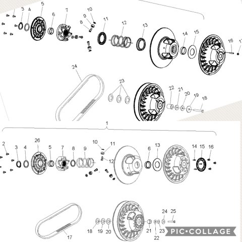

Two different belt deflecting systems in the same year. I found this gem on Polaris browse searching
The one with the plate belt deflection is for a 550 from 2009 part # 13222412
Other is the normal belt deflection on most other models . Part# 1322827
